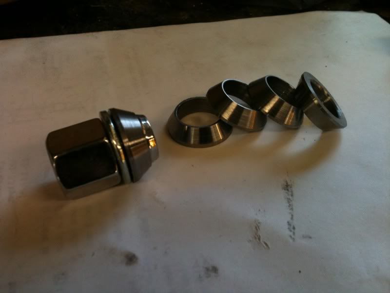

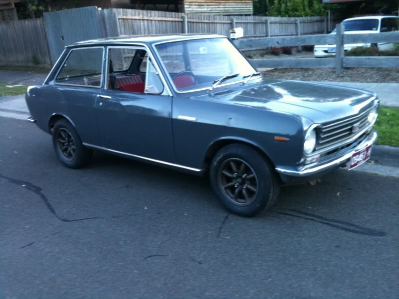

I finally got some rubber on the wheels. Some Federal 175/65R13 did the trick. They are only 6mm larger in diameter than the 12's. It's as if these rims were made fot the thou. I managed to drum up some camber shims from the spare car and a spare box of stuff I found and gave it a couple of degrees camber and a bit of caster too. i took it for a drive and she drives much better.
Unfortunately the mags need a special tapered 2 piece wheel nut so I got on the lathe at work and made some washers to use with standard shank mag wheel nuts. It worked out well in the end but I think I'll save for the right nuts but the cost over $200. It's funny, when I asked the boss if he'd mind if I used some crap he said use whatever you want. I still used offcuts but of S155. A very expensive steel.
Special washers I made.

curious what's special about the wheel nut? looks like any tapered nut but smaller socket size, which you can get in a one piece
