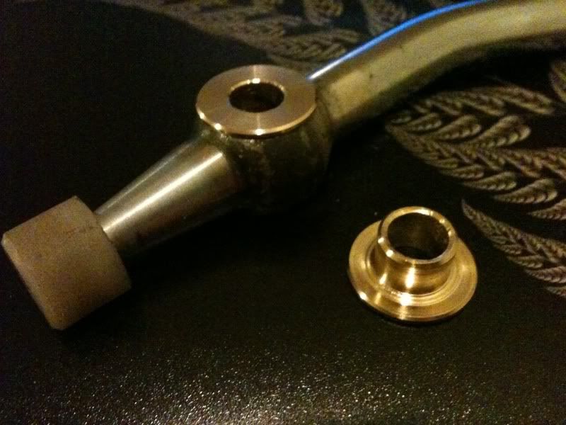

The old gear lever nylon bushings were non existent and someone had done a semi bodgie repair with some washers so while I was at work today I snuck on to the lathe and turned up a couple of bushes out of brass to tighten up the gear shifter. I'm too tight to pay $30 for them and I gave away all good ones long ago as I didn't believe I'd be playing around with standard gearbox's again.

They only took about 45 minutes to make and the material was free. I needed to fire up the lathe anyway. The worst part was cleaning up all the brass splinters. Once mixed with the coolant it was a pain to clean off the lathe. So in the end it was cheaper to make them than buy them. Plus every now and then you have to save some cash.
