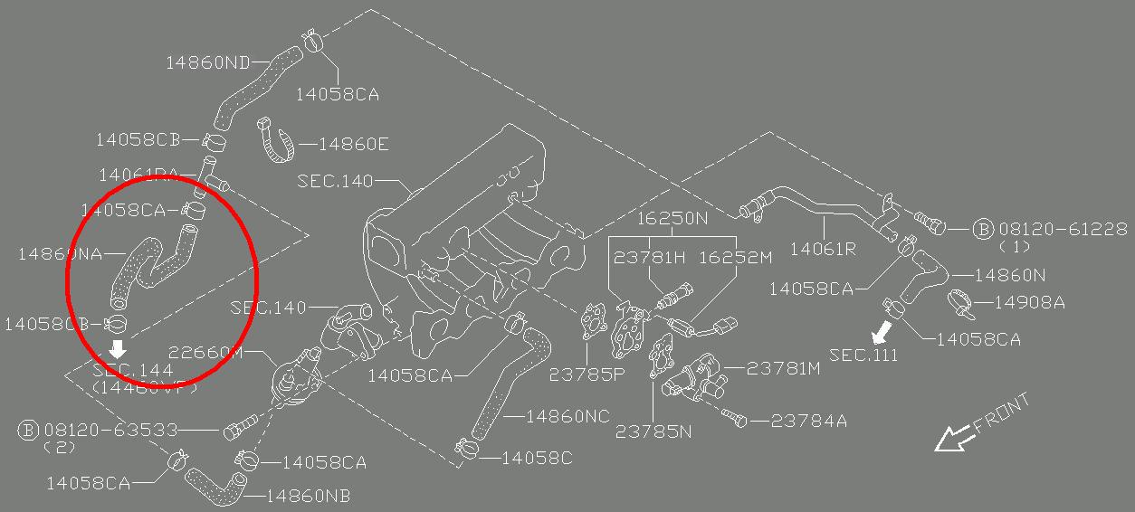

wondering where the third connection goes for this hose
as per picture two are obvious but the third that goes from the t-piece... where is that normally connected to?

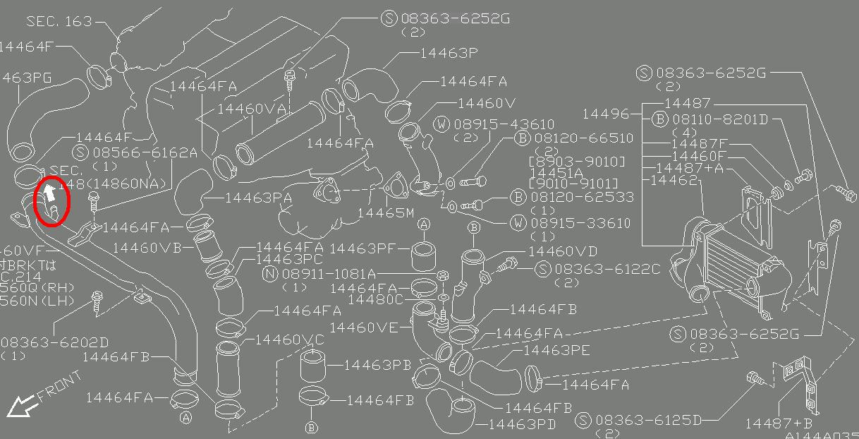

It is actually an air line, the other end connects back to the inlet/intercooler pipe just before the throttle body.

I think that the diagrams you are after are these: I have circled the pipes and connection points.
I had the old man weld a push on fitting to the bottom of the inlet pipe. It isn't very clear but I circled it so you can see the approximate location.

yeah it supplies air to the air reg and the aac. i didnt have either on my engine

cool, have sorted getting a bung welded to inlet pipe... getting excited, nearly all done
