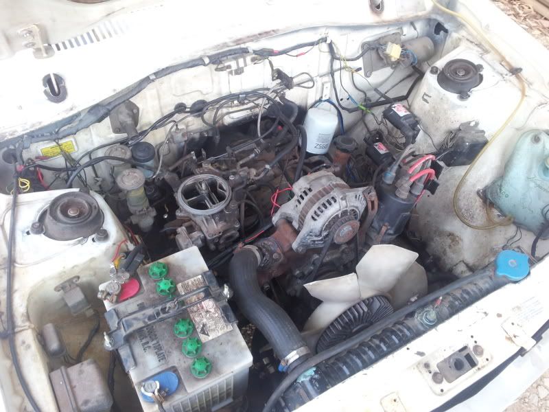

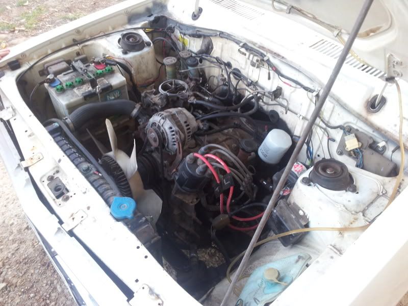

I got a new gear box mount rubber and fixed the exhaust (was hitting body on bumps). Then being overly happy with everything I bought a new battery and salt/water belt... So what's next I say...
Check the plugs, little rich, carby float levels are high (above the windows), read somewhere that lowering them will lean the carby overall... big mistake.
First it wouldn't idle. Tried putting floats back to where they were, now it won't start.
Sad person right here. Now I'm back on the push bike.

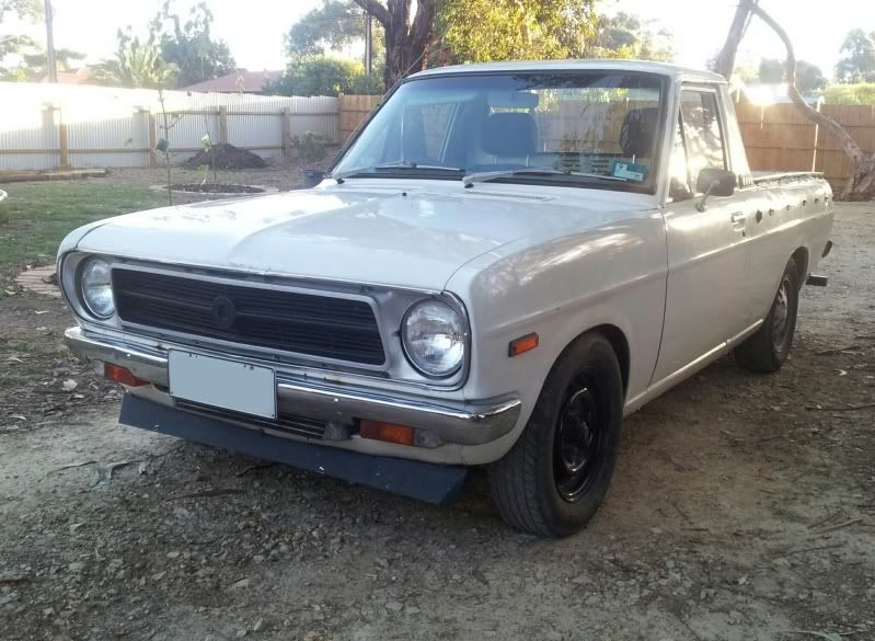

Yeah want to make a filter for it. The clutch and brake master are higher than the top of the carbie tho.
Ground clearance is fine, where exhaust passes gearbox cross member is a tad low but not a problem. The height issue is all about scrub and corners. I like corners but I haven't even put my wider rims on and I'm having to go slow at the roundabout.

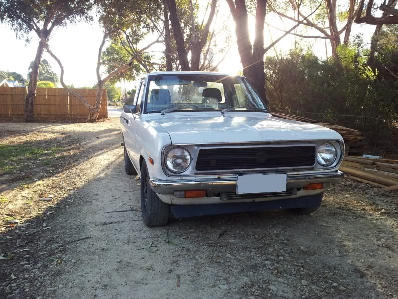

Finished and loving it.
Exhaust sounds killer now.... for a rotary.
Goes awesome, needs a tacho and carpet. Doesn't feel like it needs a tune but haven't checked plugs yet.
Stoked with the ease and result of this build.
Downside is the front is now too low.
