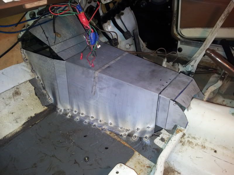

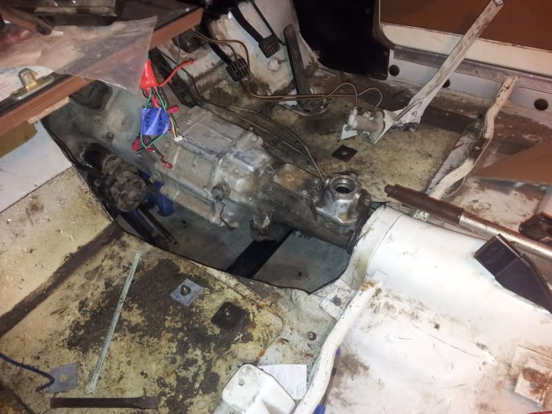

One day I'm gonna build a show car.... that day is not in the foreseeable future. So instead I build an ugly trans tunnel.
Oh and my tail shaft has arrived. Looks beefy.

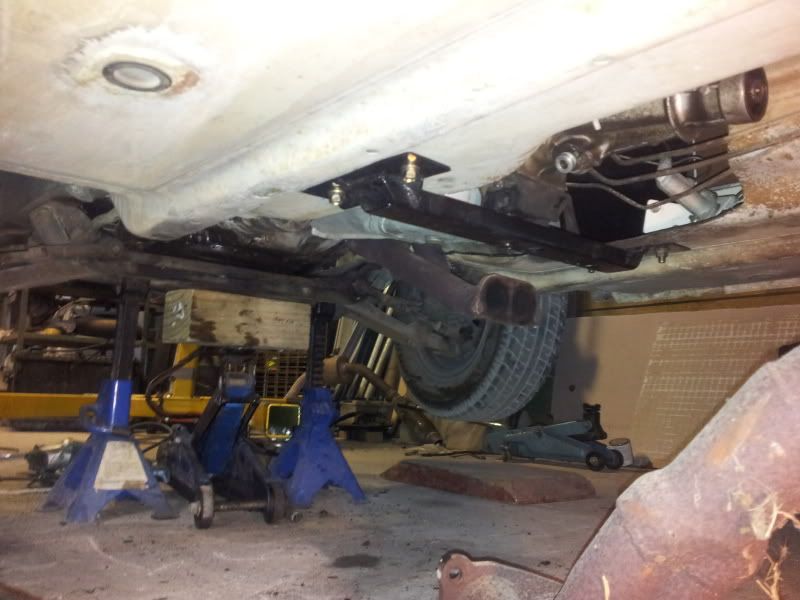

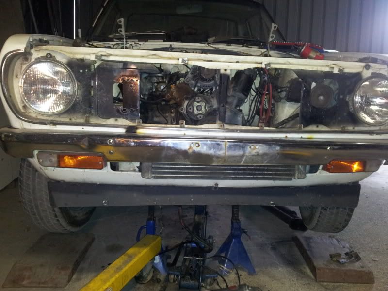

Its rough but getting there.
Was very happy that the exhaust manifold off the rx7 fitted... just... has about 3mm of clearance against the steering box.
And I'm hoping the oil cooler behind the rego plate wont stand out too much but all seems to be going smoothly so far. Just wish I had more time to work on it. Also wish it was in my own shed and that I had a shed, instead of one on the other side of town.

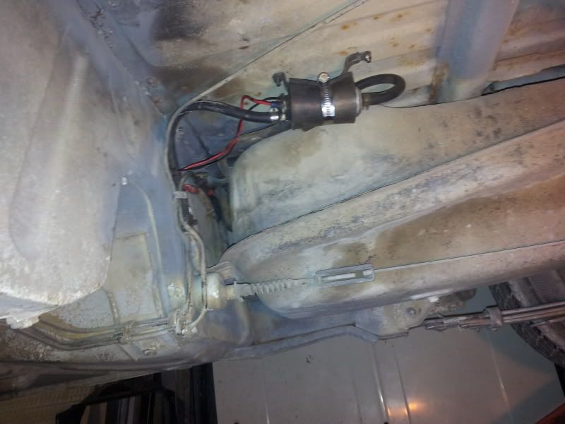

Have a look around but I know a speedo shop near me that calibrates speedos and fixes them etc also mods the cables and convert to electronic speeds etc. any speedo calibration shop should be able to...

Any suggestions where I can get an accelerator cable modified?
