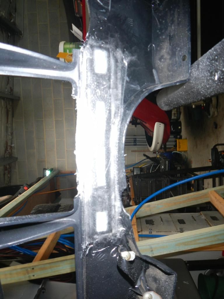

finally got some progress shots of my dash, Ive come along a bit further than this but these are the pics I've got so far. Fibreglassed all the holes from the back that I didnt want, and filled with metal and glass filler from the front. What a pain to sand. The started on the aluminum housings. Machined 100mm OD pipe down to 97mm ID to take Autometer gauges. The area of the dash where the old stereo will go will be modified to take a new head unit as well.
Pictures speak a thousand words so if there is any questions fire away.
