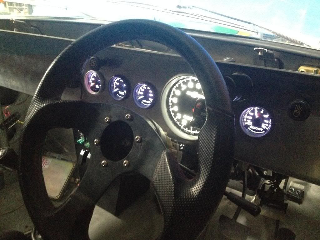

Today's update
550cc injectors fitted
Z32 afm fitted
Dash getting closer :)

Nice looking dash.
I think that will be my next years winter project. Replace all the stock gauges.
