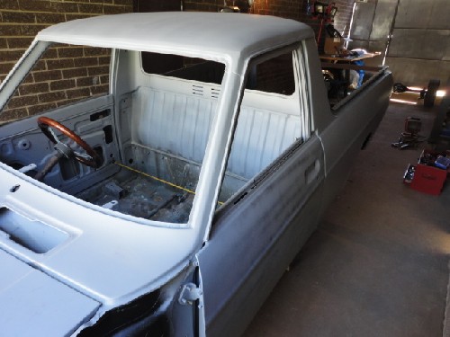

Hi guys this is the story behind my ute this was my fisrt car at the age of 17 now im 29 so iv had it for awhile now lol...
The car use to have a stock a12 with 4speed and was aqure blue was was alot of fun then at age 20 i put in a a15 which went great drove around in it for about a year until one day the bonnet came up and smashed the windscreen all over me took the old girl home and was thinking of what to do next.. I decided to buy a vl turbo and leave the ute in the shed for abit and try fix it up after traveling and being a young bloke partying decided last year time to fix the best back up me and a friend done the body work shaved the rear end seamwelded the engine bay with flat firewall the bay is smooth as and i love it now we are tubbing the rear end i just cut the tubs out and tonight i will be taking out the tray floor with the boys here are afew pics for you datto freaks to have alook at and tell me what you think..

hi guys just afew pics of how the car is at the moment tray is now all out what a BITCH of a good but for the look im going for will be well worth it.. Pics of bay engine bay hope you guys like.. More info to come with thus best look out
Will post the old pics of how the car started when i find the old memory card but so far so good.. Next is the inner tray panels are coming out them the back wall all ready for my tubbs and the flat floor sides and back panel look im after..

Hi Bevo looks good mate,ive managed to talk dave from awsome auto into moving the original chassie rails in by 2"s either side,was it a hassle unpicking the tray.Now that u have done it would u say that 15k is around the wright price for the following.Unpick the tray and chassie rails put them back in in their new position,tub it get the diff shortened mount it,buy the rear wheels(convo pro)and put in the fuel cell.What do u think?
