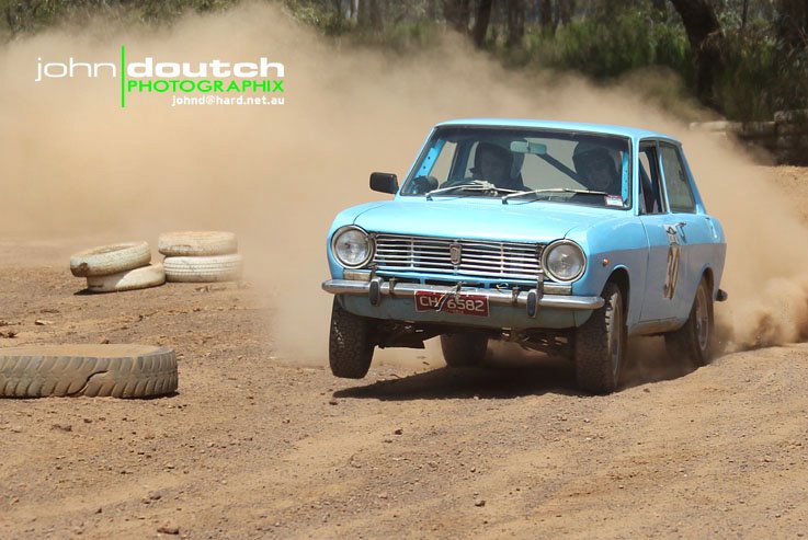

Well this 5 speed 56a is in and working ok. My effort at the Bagshot rallysprint on Saturday exposed several problems:
. Steering is too slow;
. Rear suspension is too soft;
. Diff is broken (pinion actually).
What can I do to speed up the steering?
. shorten the steering arms (is such road legal?);
. quicker steering box (currently 15 to 1);
. normally a smaller steering wheel is an option but I am already down to the smallest I have seen.
Anyone know the ratio or a 1200 (B110) or 120Y (B210) steering box?
My gearbox saga.
http://datsun1200.com/modules/newbb/v ... =ASC&type=&mode=0&start=0
Mark (photo from Saturday attached)

Probaly the easist will be to fit a steering quickener.
Looking at the picture, the weight transfer to the rear looks quite good as you have enough grip/power to lift the front wheel.
