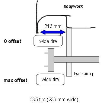

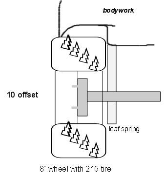

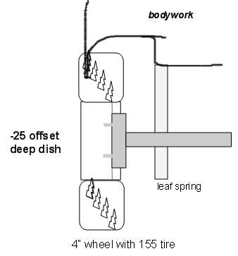

you've also got to factor in how much leaf springs allow the rear axle to move laterally under hard cornering (which would surprise most people!) and for the axle to pivot about the centre of the axle in single wheel bump travel.
So true. Many have reported using 205s on the rear but along the lines of your comment I would not recommend it but leave a little more room than they are running. So I listed 195-width tyres as the max. If you keep the tire diameter down, it's less of a problem body-side. Many 1200 owners are running their tyres right on the edge of the body lip with occasional rubbing.
Anyways, here's how Offset affects where the tires are located
(not entirely to scale, but fairly representative of the rear of a Sedan)
0 offset will hit the body lip. You can roll it to gain the needed clearance, but it's not enough.
Any more offset than this and they hit the leaf spring
And of course with any Negative offset, the tyres will stick out -- regardless of the wheel width. But the deep lip rims do look beautiful.

Now about WIDE tires
235/45R17 requires a wheel width of 7.5 to 9"
235/45R17 might work fine with +10 offset and 1" flares?
You could also go with Zero offset and larger flares. Zero offset will space the tire farther outboard.
This is also a fairly tall tire (about the same height as 185R14). So the rear should be at stock height and fenders need to be flared out, or cut away a bit with overfender flares.
