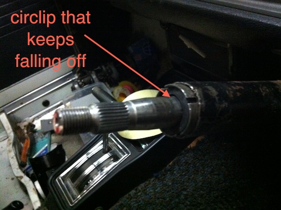

alright finally got a photo of the shaft that keeps popping the circlip off tell me what ya think
jpg  steering shaft.jpg (86.07 KB)
6964_4f3a33b4b08da.jpg 567X423 px
Posted on: 2012/2/14 10:13
Re: Steering box troubles
its auto- time for engine converion in that tunnel
Posted on: 2012/2/14 10:36
I don't see a clip in that photo, but it looks like the bushing is not screwed in far enough.
Here's mine, there is no circlip on it:
