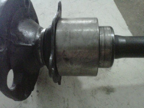

hi guys, after some time i made the decision to use the ae86 axle bearing cause it is stronger but the thing was the inner diameter of the bearing was bigger by 3.05mm, so i decided to make a mid-piece to clear the 3.05mm you will see it in the pictures :)
this makes me very happy cause you guys now know a way to solve a problem :)
Datsun 1200 ute h165 axles on shortened ae86 diff housing & LSD :D
also i am very sorry for the crappy pictures i don't have a good camera just a crappy cellphone

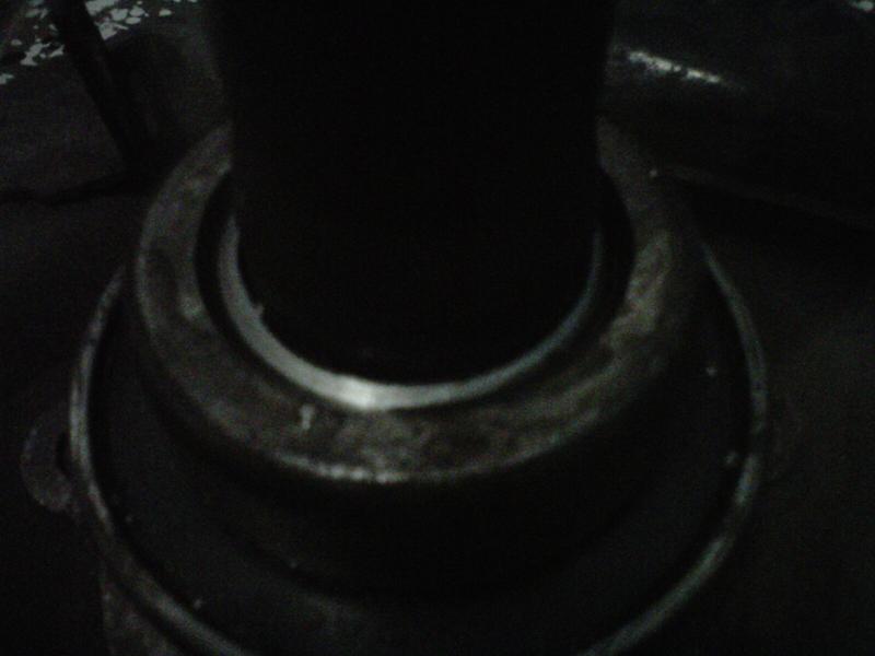

so... i got the 1200 housing and both axels, tested them in my ae86 shortened housing and lsd diff, they fit!!!!! also the ae86 bearings are bigger but i can use 1200 ones cause they have the same diameter outside the only problem is the shaft seal, it is not the same cause ae86 axels have bigger diameter, i have to figure out witch one will i use, will update on next weekend cause don't have time right now
cheers from Dominican Republic :)
