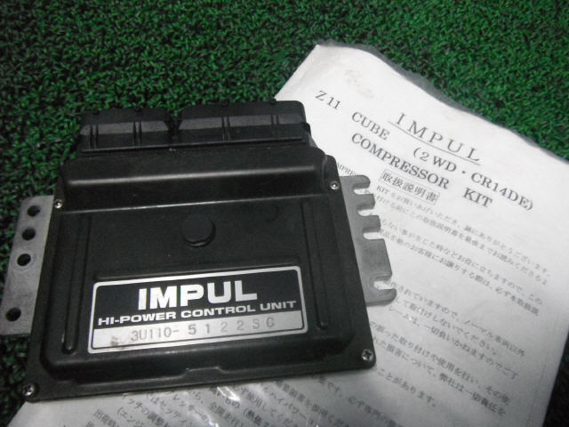

Very interesting read and thanks for sharing info to forum revhead.
also,Impul makes a supercharger for this engine and claim an increase of 35hp.
jpg  b.jpg (58.06 KB)
15239_4fa3d5ba742e9.jpg 640X480 px
jpg  a.jpg (73.61 KB)
15239_4fa3d5cb06fad.jpg 640X480 px
jpg  c.jpg (59.70 KB)
15239_4fa3d5d7c0b21.jpg 640X480 px
