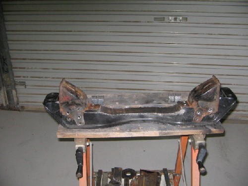

Well picked up the L18 from depot today (Thanks Supafatto) Notched out a X member and welded a plate back in, so motor can go nice and low. Unpicked the Stanza mounts and just sat them on. going to bolt it all in me wagon tomorrow and mock it all up for ute.
jpg  Xmember 001.jpg (95.36 KB)
10290_5180c61045f11.jpg 640X480 px
jpg  Xmember 002.jpg (94.12 KB)
10290_5180c61e0d2f3.jpg 640X480 px
Posted on: 2013/5/1 8:37
