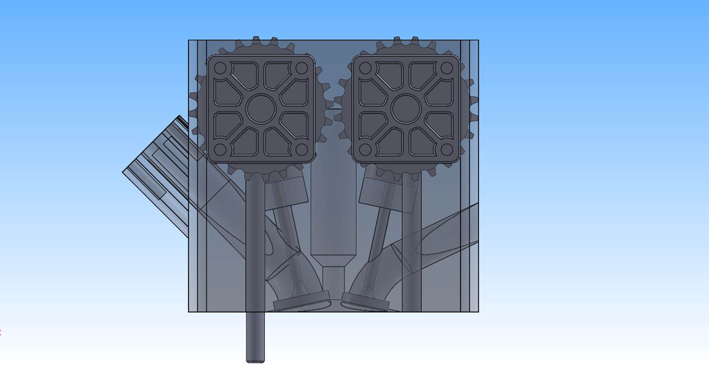

I have been working away on this slowly, here are some pics of the progress.
I still have to model the oil galleries and water galleries and play around with different ports using flow simulation
At the moment it is GA16DE cams, valves buckets etc
Comments or opinions are welcome!!!

at the rocker cover, put DATSUN instead of NISSAN.

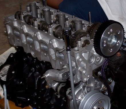

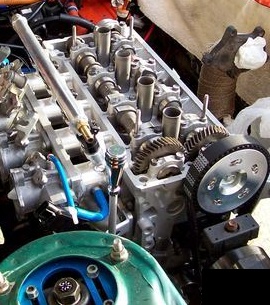

Very very nice work, just so you know there is also a more commonly available engine you can pinch the cam gear from it has a much simpler exhaust slave cam setup found on countless late 80s and 90s corollas the 4afe or 7afe.
248hp from a 4afe has proven modern narrow valve update is even better than any formula atlantic 4age or 20v 4age wide angle valved heads.
http://board.tercelonline.com/viewthr ... ction=printable&tid=45398
if you look at the slave cam with single belt driven setup it could be much easier to be modded on an A series.
http://forums.club4ag.com/zerothread?id=11272

any chance you cut put 2 plug per cylinder? the more the merrier.
