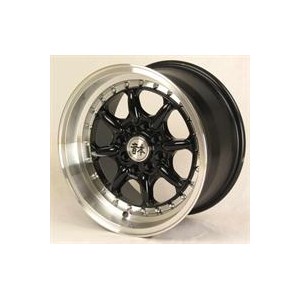

hey if your interseted in any of those mags and anymore that i post up msg this guy and say u were told by me Dave @ BRAVE MOTORSPORT about them
Kane 0406366502 from eye candy auto assessories
many more to come
told ya
