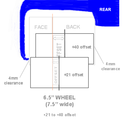

Here's a virtual mockup based on 220 mm wheel well. You can double-check these measurements on your ute.
It shows that a 6.5 +44 wheel might be touching the spring. So a minimum of 5mm spacer is needed. 15mm spacer might get it close to to flush with body side and have 15mm clearance to the spring.
With flush 6.5 wheel, then the question is which tire width would clear the inner fender ... obviously stretched narrower will be required.
Posted on: 2012/10/20 20:22

Yes. How much spacer is for you to decide. Get out and measure your ute, compare the measurements to the graphics above.
* I estimate a +5 spacer is required for +44 6.5" wide wheels for an average 1200. Or if you want to get them flush to bodyside (which means the tire rubbing will occur), +15 will be closer.
* townie says "6.5 inch wheels need +20 to +16 to fit properly"
Of course it depends on the offset of the wheels, and the side-to-side tolerance of a 1200, which has been reported up to 10mm difference on different stock 1200s.
Posted on: 2012/10/26 1:15
