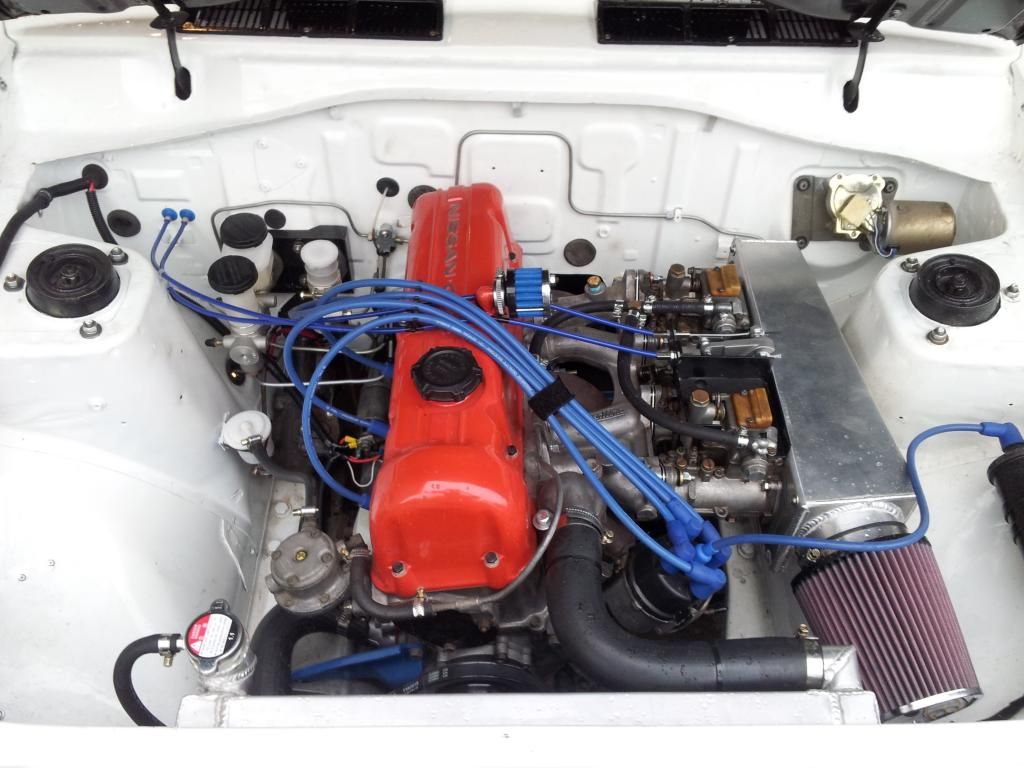

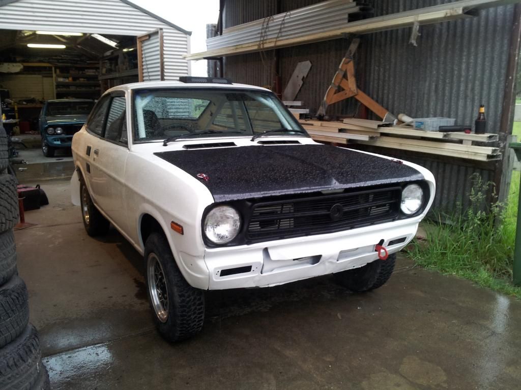

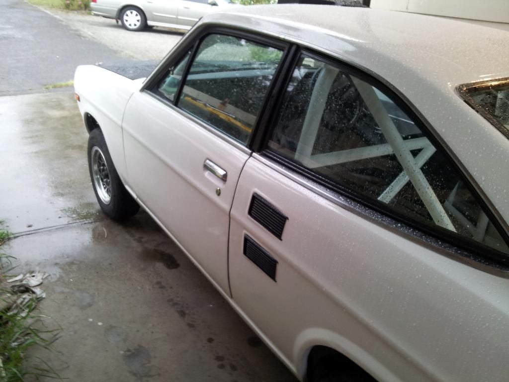

Dad and i put an L16 in our 1200 coupe rallycar, its standard with twin carbs and a stumpy 5speed.
We made bigger trans tunnel notched the x-member and got a aluminium radiator made and put the thermo fan on the other side of the radiator.
It has quite alot of power and goes like a rocket

Dat12OO Posted on: 2012/12/7 8:01
here are some pics of our coupe
