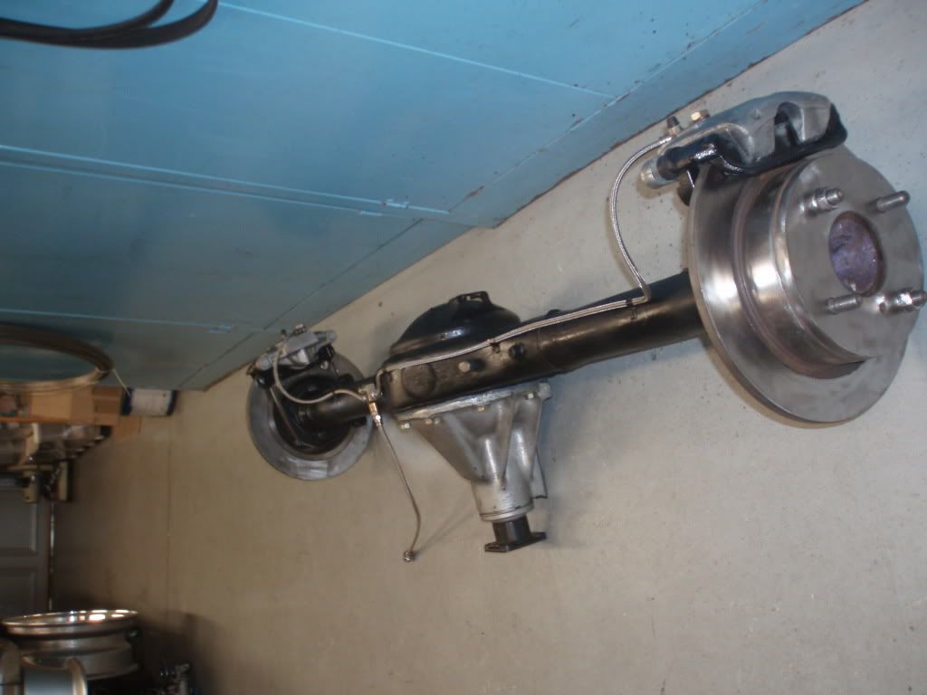

I did as Piggy described when I did my R31 disks on a H165 housing a couple of years ago. Welded some doughnut shape rings in the centre of the R31 caliper mounts to retain the bearing more to my liking. I also ended up using calipers off a Commodore of about the same era as a R31, as I did not need the handbrake assembly type calipers. I did use the R31 caliper hangers though. The whole setup works very well. Pics attached.
