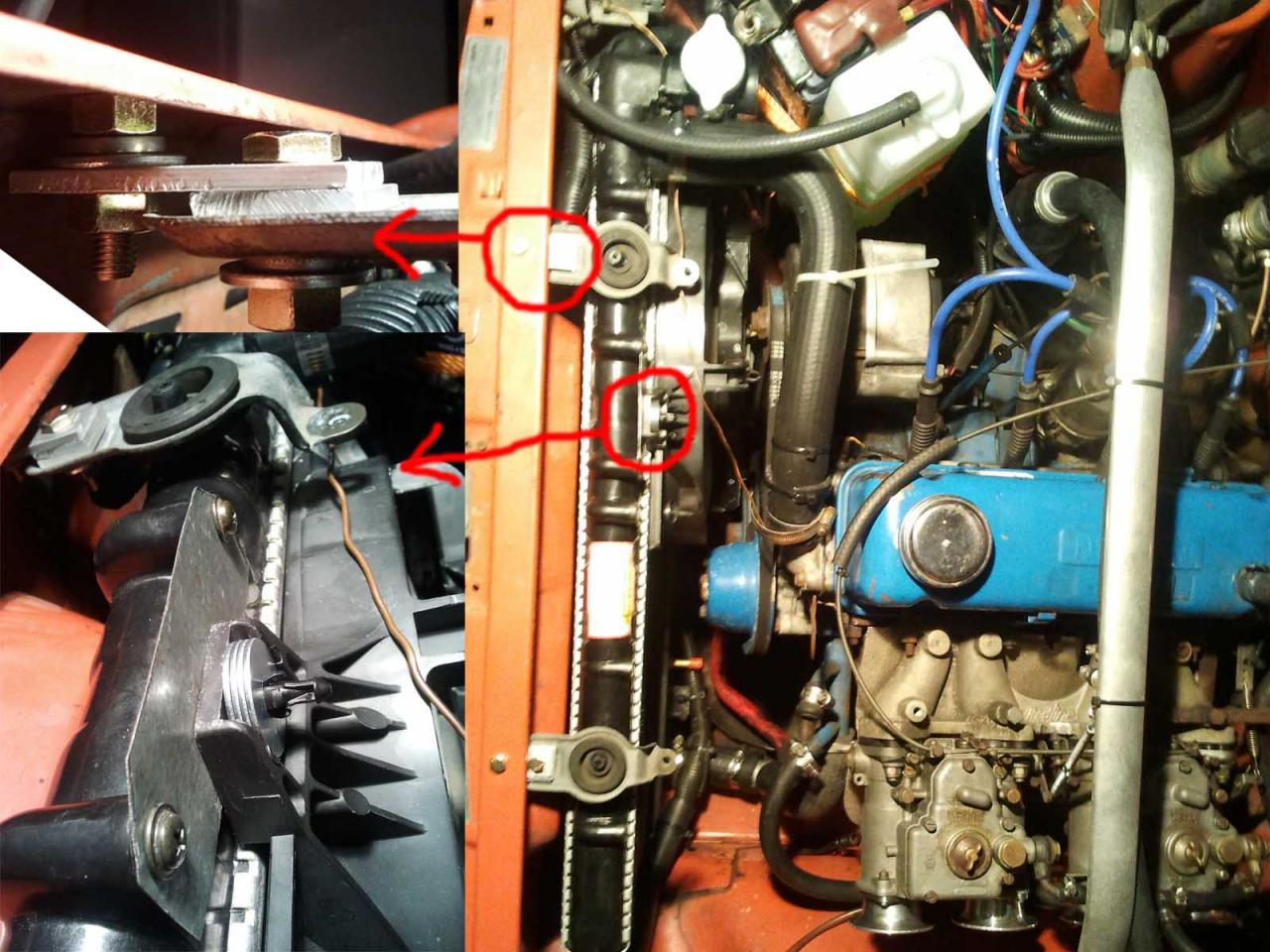

smariese Posted on: 2016/7/3 20:11
hi guys...
im getting sentra b13 (ga16de) radiator. is that easily mod to datsun B310?
#18 Re: Radiator Upgrades - Read the tech wiki looking for something in Australia or ebay
ddgonzal Posted on: 2016/7/4 8:01
That radiator needs zero mods
Mods to the B310
* drill small holes in radiator panel to screw on the upper pin mount brackets
* drill two holes in bottom radiator panel for lower pin mount rubbers
* move the horn
Selecting suitable radiator hoses
lower bracket
upper bracket
