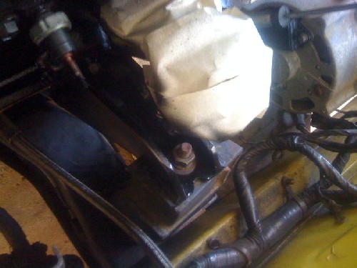

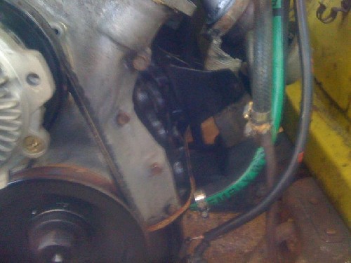

engine conversion all finished, brought it back to my place yesterday to start working on all the little things - hydraulic clutch, fuel pump, engine bay wiring, oil cooler, radiator and fan/s, etc etc
here's a look at the finished engine mounts and manifold
