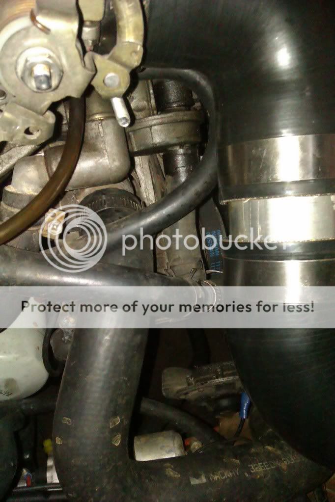

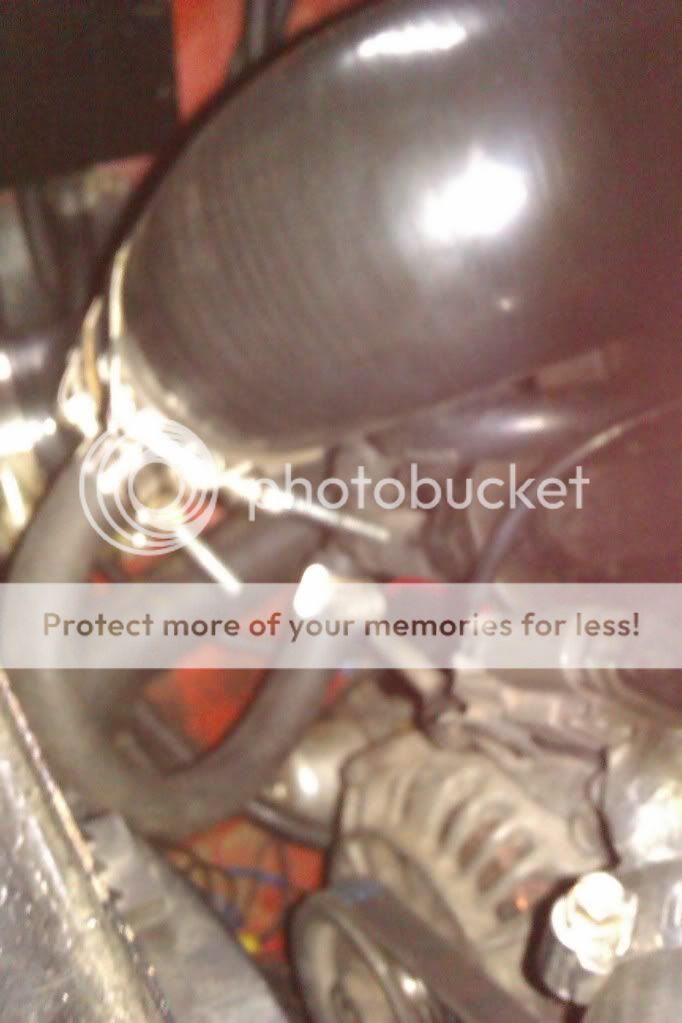

mine isn't 85 anymore
replaced a kinked hose and ran the boost signal from the plenum instead of turbo compressor
now it revs to 6000 and holds 9psi right through
was maxing out and blowing lots of fuel smoke by 4500rpm before
drives awesome now (wish i could do the dyno and phillip island again), i think the big change was the kinked hose, i cant see the different boost signal making that much difference, i dont know what the hose does... see pic... it goes from inlet pipes to a large diaphram type unit and somewhere else under the inlet

Same result as me when I took to simon in same setup.
So with my plenum made 53kw, add a cam and I reckon close to demacs 60 rw kw.
Cant wait to get stanza up there for tune and my other parts
