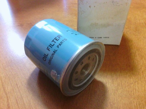

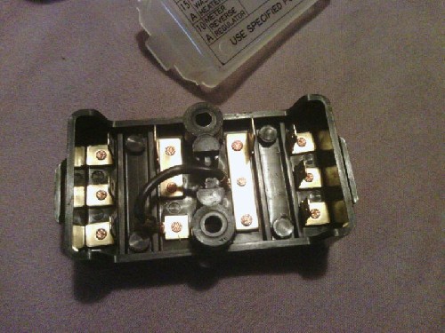

Thanks guys for the help and comments. I think it might be awhile before the gasoline and air get a chance to ignite inside my engine. I have so much work to do I don't even know where to begin, it is actually stressing and anxious to think about. Alot of the build i can still do myself but at some point it will have to go into paint. And also i am going to need a mechanic to build me brakes, fuel lines, fab a transmission mount, and a few other things. Still faced with a dillema where my driveshaft is too long and doesnt mount to my diff anyways, different flange. Also no idea what condition the rear axle assembly is in and whether or not its a H145, 150, 165 or 190. I have my 5 speed 60a gearbox and A14 so if it is a H145 i wouldn't want it to be on there.
In the mean time I got this fuse box from Greece. It says 1200 LB110 but seems to look like it will work with the B120. And also found a few NOS oil filters.

B110 & B120 use same fuse box, but there were three revisions. See Fuse Box
All B120 came from the factory with H165, even the first ones. But sometimes they get swapped. Anything can happen in 30-40 years. Easy enough to tell. H145 has square-pattern flange. H165 has rectangular pattern flange.
