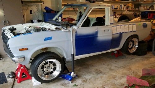

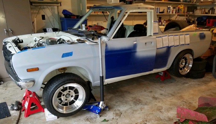

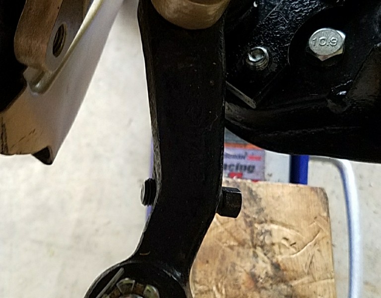

Months ago i had a shop pack the front bearings and install my king springs.
Also had the rotors machined.
Installed the radius rod and bushings today. That was the last piece of steering to be completed.
Ages ago i bought a pair of RCAs from techno toy tuning.
I had a very difficult time installing the strut and i see no way i can fit an RCA in there. So i dont think i will use them.
I am using King spring superlow as the springs.
Also realized i cannot get a brake caliper with the strut installed. So i have to undo half the work i did today.

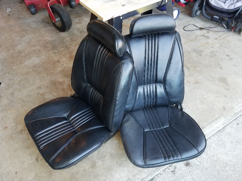

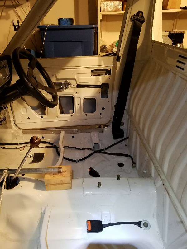

Since i sacrificed my race seats to the Avacodo i bought a pair of excellent black B110 Coupe seats. They are not ute seats so not as roomy but they will do until i can import some ute seats.
I installed new seat belts. They are military surplus Humvee. Test fit the seats and the new seat belts are a little short. Seat belt extenders will fix this.

I seem to recall this method to get the caliper on/off with strut installed:
* Loosen one strut bolt
* Remove the other strut bolt
* Rotate strut so that you have enough clearance to insert caliper bolt
* tighten caliper
* rotate strut
* install strut bolt

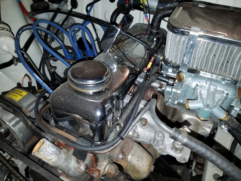

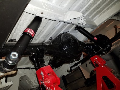

The ole ute is gettin dusty these days.
Progress made.
Seat belts installed.
Rear loom repaired, there was some crusty wiring to repair. Retaped the loom and installed.
License plate lights installed.
Front and side indicators bulb changed cleaned amd installed.

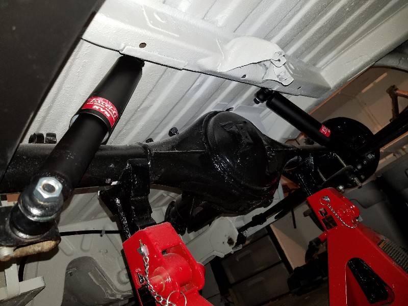

Shock absorbers. Excel G replacements from oz installed.
Need some m12 split washers.
Go fast rocker cover bolts installed
that's all i can remember at the moment.
The shock upper mounts were covered in Raptor liner so i had to buy an m12 1.25 die ans rethread them. Clearance was a pain but my trusty big ass adjustable wrench did the slow job okay.
