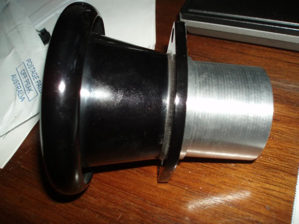

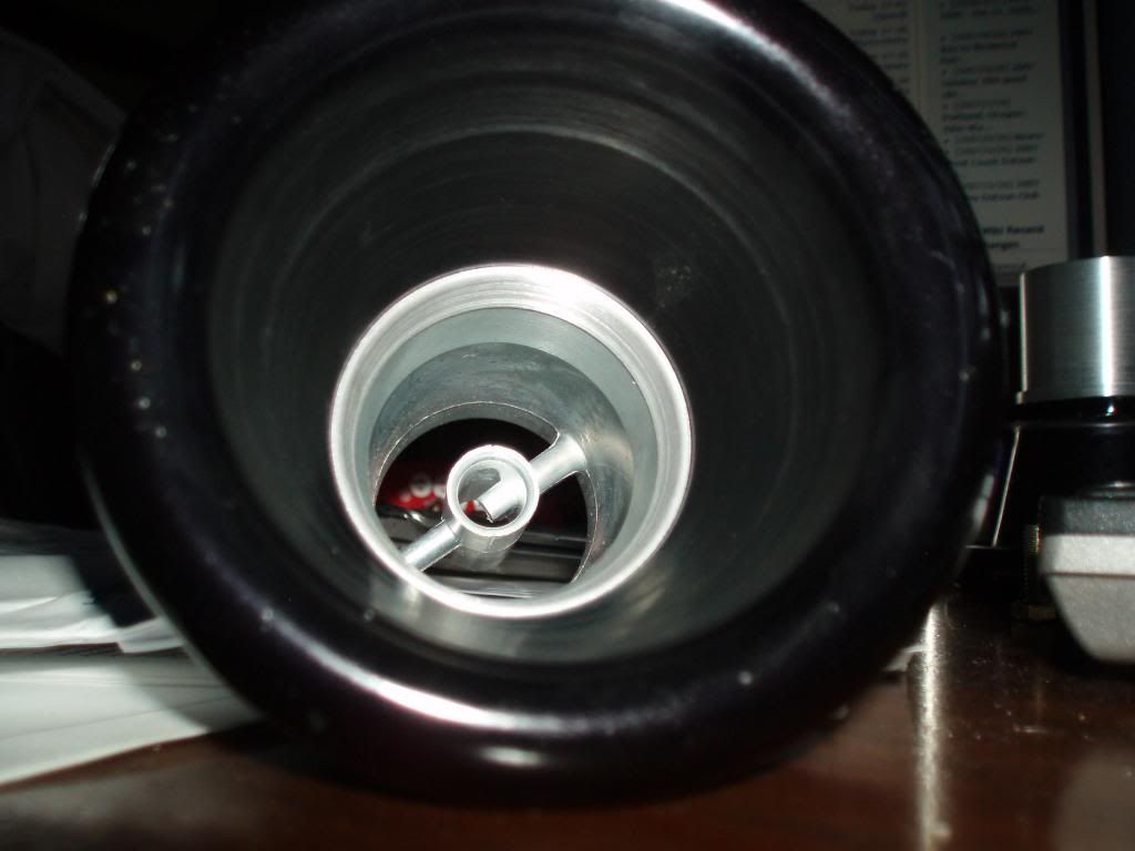

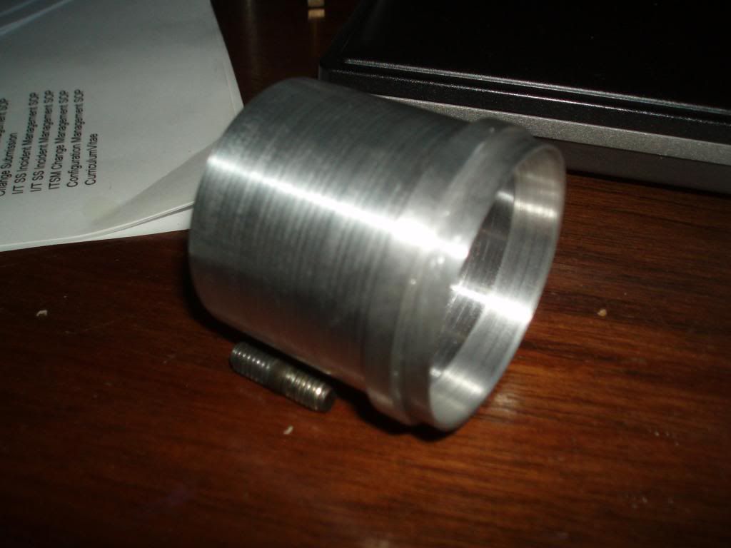

Jmac,
If your referring to the black ram tunes, I bought them from Japan, They are actually for Weber 45 DCOE's. I spent some time on the lathe to turn up some adapters so that I could fit them onto my 40 DCOE 2's. This particular model of DCOE require the slide in type ram tube to retain the AUX vent in position. See pics for reference. I went with these ram tubes because of two specific design features for improved performance a) the full radius bell mouth and b)the tapered bore. OEM Weber use parallel bore.
cheers
benny
