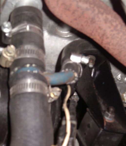

D Posted on: 2014/3/17 7:13
Nice sink hole! just wondering if the guides where shot then that could have been the issues with the inlets getting combustion somewhat?
Just a note if the heater hose gets in the way you can tuck it away by cutting the outlet pipe an inch and a halve from then reverse it so the heater outlet faces the block so your hose can just run along the block and straight into the firewall. Did this to the 1000 engine and looks way better less clutter etc.
quick and easy mod at breather pipe just secured with black tie clip.
http://datsun1000.com/UserImages/d/La ... hose%20redirectioning.JPG
http://datsun1000.com/UserImages/d/La ... ion%20under%20exhaust.JPG
