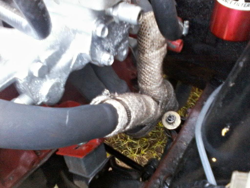

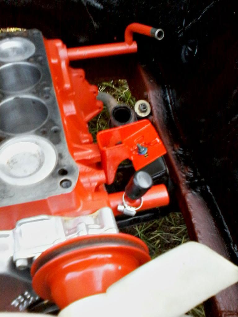

Hey I also have an a15 in my 71sedan an also have some close fits Exhaust at 1 time was burning out the idler arm bushings,I had to get some heat wrap for the pipes.The Engine too cross member brackets are home made and i have no problem with them since for about 10+ year on my Late model a12.So i Have a few pics for you

Interesting about the heat wrap Darren. No problems since using it?
Tom - Now the motor is in and run-in, I am considering re-doing the engine and g/box mounts to sit it lower and further back like you have mentioned. The car is currently driven daily until another project is on the road, but it's primary use will be for Hillclimbs so I would be doing this for better weight distribution. Is it possible for you to post pics of your mounts?

Two things. Currently I just use two flat plates in conjunction with the standard motor mounts.
Many use ago my fabricator buddy scalloped out the center of the crossmember so that the motor could be lowered 2 inched by solid mounting it. For the tranny he made up spacers so the tranny would also be lowered as well.

Yea the heat wrap holds out pretty well i even smell it some times.I only race the front wheel cars heheh,well,thats the most types of cars our roads.I have changed two pairs before the heat wrap...
