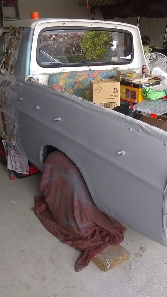

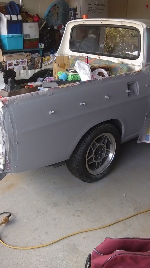

Quick Update on whats been happening over the last couple of months. I've finally gotten a new Job and things are starting to flow smoothly again for myself and this build. As far as progress has gone I've done both rear 1/4 panels back to bare metal and brought them back up with new primer and sanded/bogged any light imperfections. I've started wire wheeling the tray back to bare metal to fix up the surface rust and will be applying some spray liner on down the track.

Piccys of the progress.

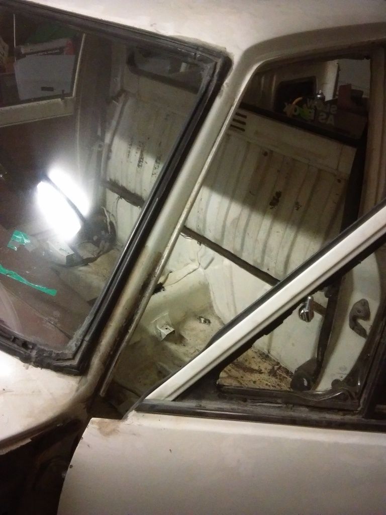

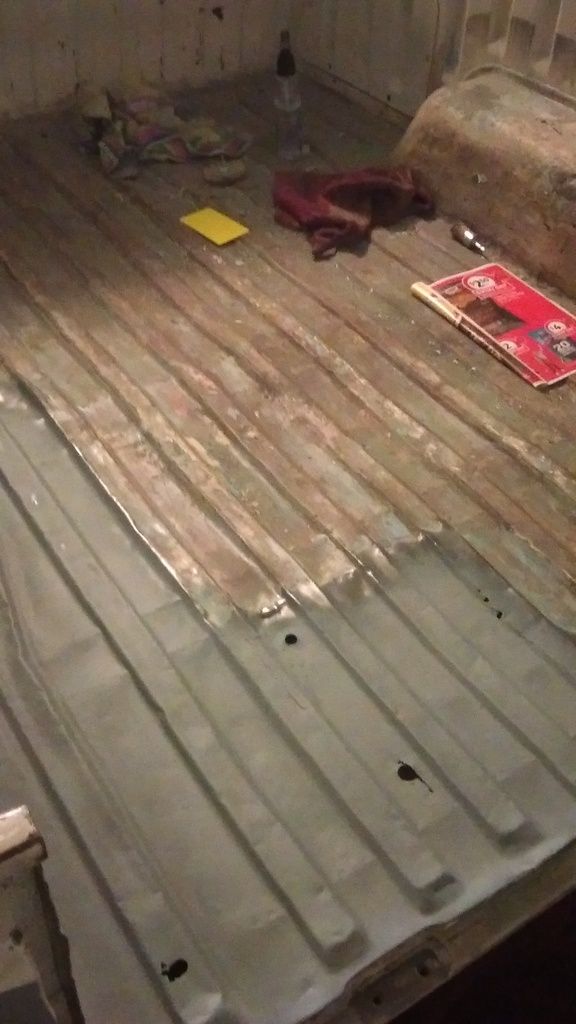

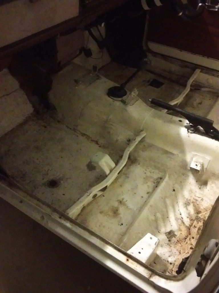

Pulled out the seats and most of the interior today to see the full condition of the floor pans and the back wall. Unfortunately there's quite a bit of rust and some work will had to be done. For the time being he's some pictures of the progress.

Seats out.
Floor pans aren't too bad but better be safe than sorry.
Rust along the rear wall. Has holes in it leading out onto the tray floor..
