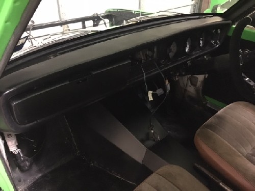

Whilst I was ignoring the flywheel bolts I took some time to get some wiring sorted out. Engine loom is run through the engine bay, ecu mounted and ready to go. I have cleaned up the 1200 loom and have it run through. Got a re-trimmed dash as well a few weeks ago so have put that all in. Cables etc also run ready for the motor.
Flywheel being machined tomorrow so hopefully this weekend will see some serious progress.
