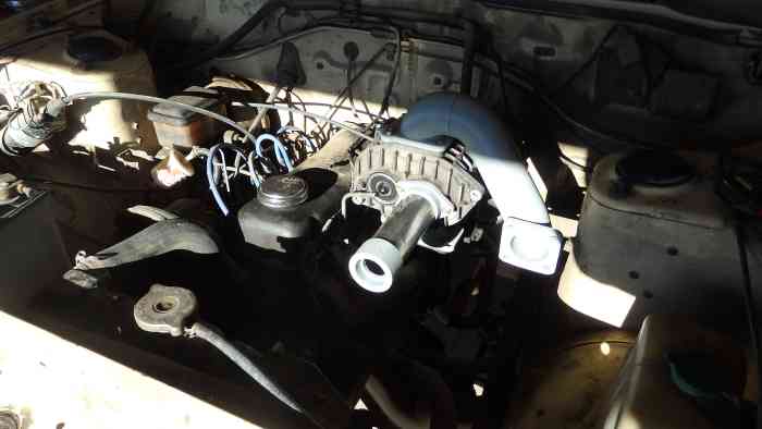

intake done

John was the angled version too hard or still coming?
Theres a 998cc mini that produced 78hp at the wheels with a single bike carb
There is one vid on youtub but 78hp atw is as much as the best NA A series make

That looks great SC. I found a Combi on youtube that made about 115Hp. I thought that was very good for such a small charger. Be interesting to hear how they go on an A12. It will look good either way!

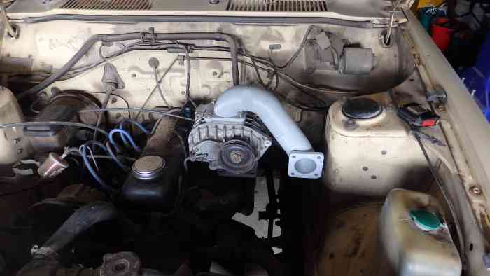

Working on the extented snout,will do a steel snout and aluminium snout. Thinking about making a snout kit that can be cut to size then welded.
I have designed a fully adjustable sliding snout (130mm-200mm) no welding required but i think that will add too much cost.

Still working on measurements for final kit mock up, I have used 50mm for inlet but I think I can drop that to 44mm to give a little more clearance under the bonnet.
