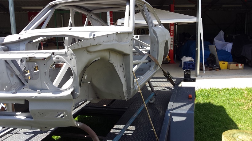

Howdy,
Yes the car is actually finished.
I completed it in October.
I assumed that my new avatar photo was a give away to
the "Blue bastard" being complete.
The name "Blue bastard" has to do with trying to get it started.
more on that later.
Just a tip for everyone.
Spray painting primer at home in the shed is possible. . .
But without the proper ventilation it is very hot and smelly work. . . .
I tried to seal up an area to stop overspray filling the shed,
which worked but it created an area with no air flow so was
like spray painting in fog. . . .
luckily I have a good face mask with fume filters fitted and I
worn disposable overalls.
