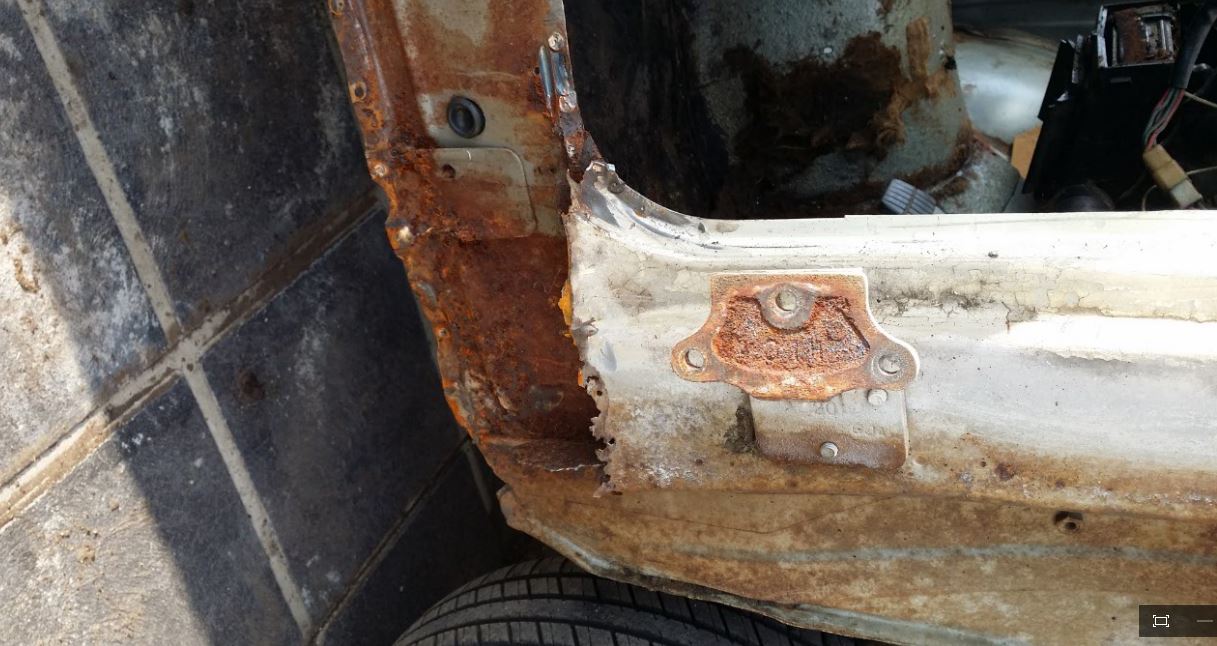

So finally removed all panels, sand blasted and applied a coat of rust-not :)

nice --rust is almost as bad as my 4 door --good job --my welding is crappy --nice repair job

Thanks buddy,
Ya, rust is a pain.
I know it is not possible to make it 100% rust-prof however I tried to get out as much as I could and treated it with rust-not and applied POR15.
Hopefully this will last me another 20years :)
