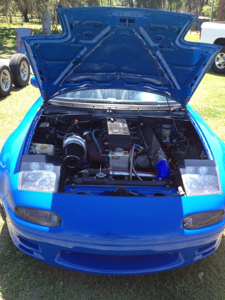

http://www.engineswapdepot.com/wp-con ... 0-B2-with-a-VW-VR6-08.jpg
Dont know what else was done to the Miata but the factory vr6 engine is 143kg
which is lighter than a factory SR20DE both dressed
