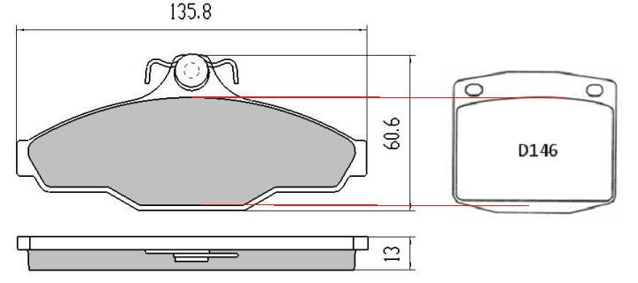

The early A10 brakes look to be stock Japan-built calipers with D146 pads (?) which are taller than the B310 type, which in turn are just a little wider than 1200 pads. So two sizes bigger than 1200 (but still not very big)
D146
Backing plate width: 63.3 mm
Backing plate height: 56.4 mm
The Girlock pads have a different shape

Thanks David. Yes the ones I have are the ones with the small rectangular style pad.
If the piston and bore are serviceable and I can get a seal kit for them I might just rebuild them. Otherwise the Girlocks would be an improvement. I'll have to measure my rotors as well, as I think there were three different rotor sizes on the Stanzas in Aus.
