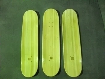

How about composite bamboo instead of carbon fibre as it
will be just as light add a nicer cream tone than cold grey
and ability to control the bamboo fiber color with a tint?
https://cdn.shopify.com/s/files/1/2182 ... x1024@2x.jpg?v=1505532414
https://www.kingofwatersports.com/imag ... boo-skate-cutout-zoom.jpg
tinted bamboo is pretty nuts
https://sc02.alicdn.com/kf/HTB105s5PpX ... ard-decks.jpg_350x350.jpg
