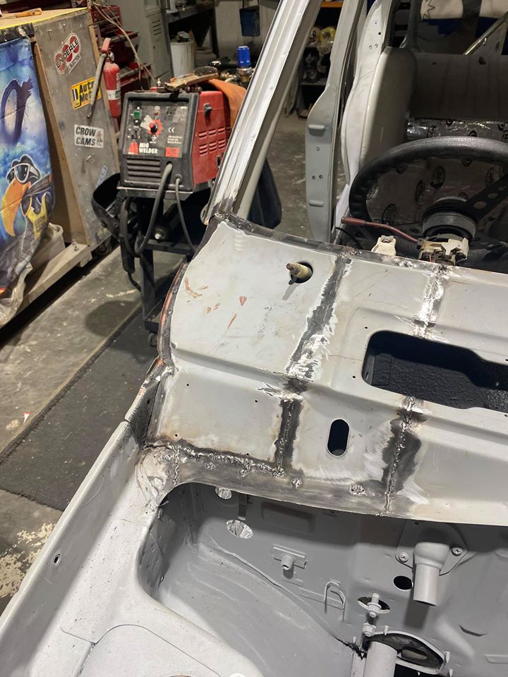

nickmitty Posted on: 2020/3/2 6:32
Finally front done

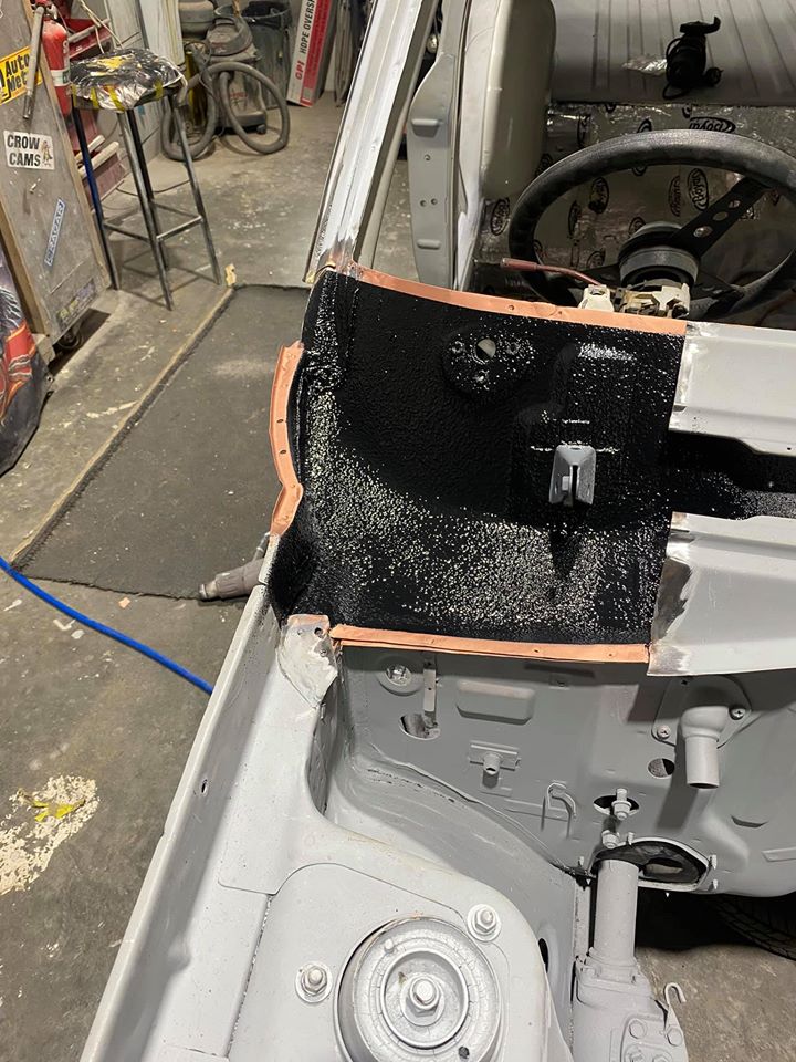

#167 Re: wagon body work
nickmitty Posted on: 2020/3/2 6:08
lamb_daiquiri
Spoke to Ray , said the " Copper Spray " is
WURTH RUST-STOP QUATTRO 4 IN 1, PRIMER, ADHESION, CORROSION, WELD THROUGH
Said it was extra important to use when welding a seam or fold so that both
plates / sheets / lips dont rust or corrode rubbing or touching each other or use
when a sheet like a floor is sitting on a rail or brace etc . Said it comes in Zinc too
