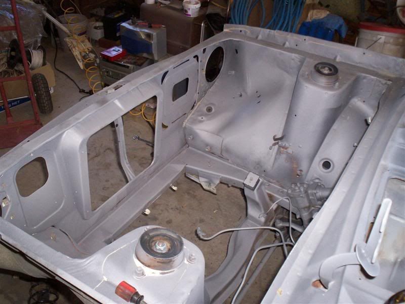

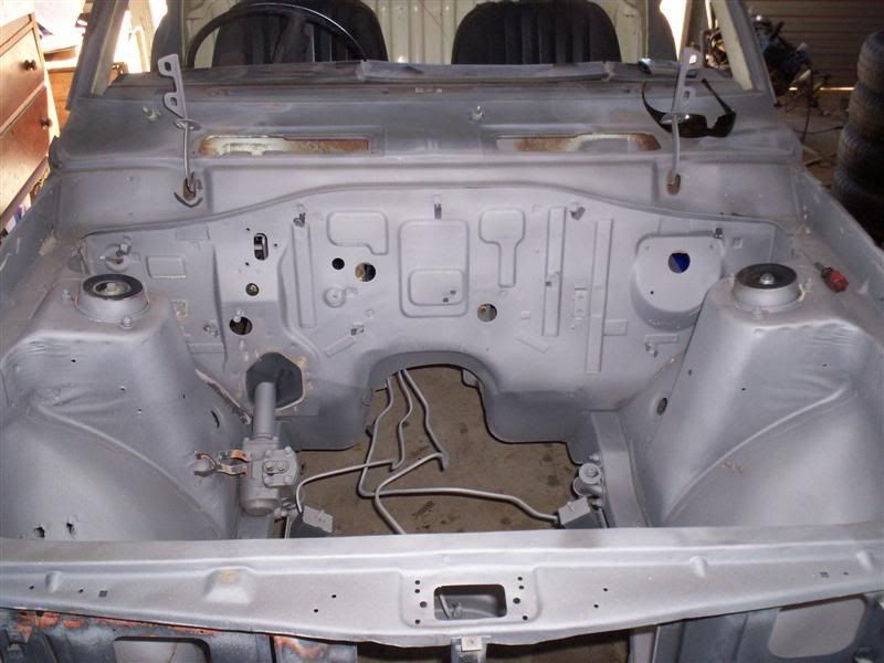

Mildman Posted on: 2007/3/16 7:55
I suppose I should have linked this picture instead.....shows the engine bay.
It's on page 7 of the evilbetty thread
http://datsun1200.com/modules/newbb/viewtopic.php?mode=viewtopic&topic_id=22424&forum=1&start=120&viewmode=flat&order=1

WARDY Posted on: 2007/3/16 11:54
Or u could have gotten it sand/bead blasted.. i got my engine bey, tub and both doors done two weeks ago for $200 saves a lot of time.. only took half hour
http://i149.photobucket.com/albums/s4 ... oute-1032007002Medium.jpg
http://i149.photobucket.com/albums/s4 ... oute-1032007001Medium.jpg
Wardy

Skey Posted on: 2007/3/16 12:11
Pics up for Wardy
