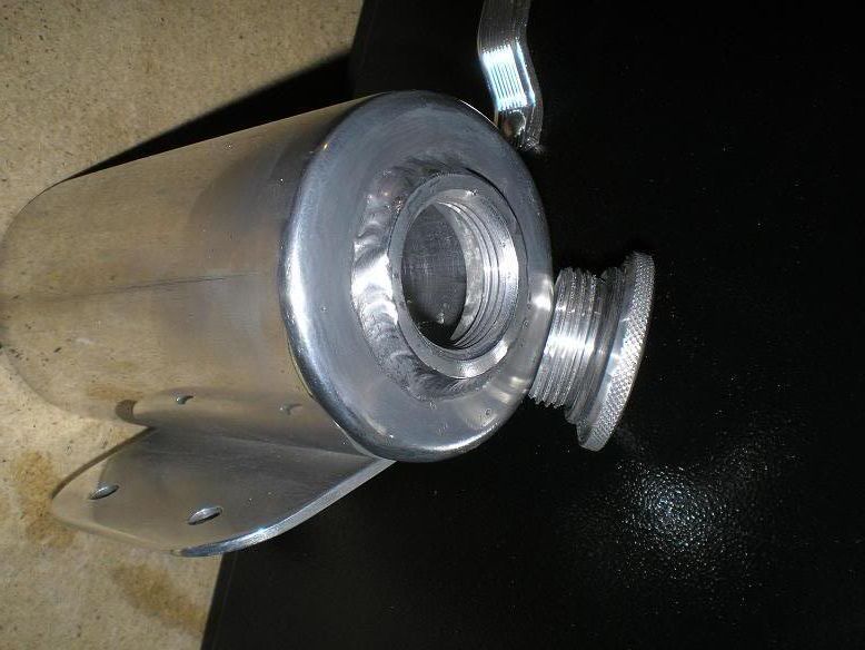

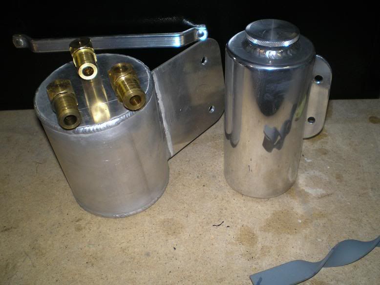

I really like this cap it is neat and tidy and has a custom made look to it. Included in the pack is the cap and also the threaded part that you just weld to the bottle.
Radiator overflow bottle and oil catch can
Radiator overflow bottle cap

thats the same thing im after, do you have any more details........ are you saying you bought the cap and weld on thread? or did it come with the catch can? any details would be great
#4 Re: catch can designs
BAD310 Posted on: 2007/8/27 0:22
Yeah, I got the cap and the threaded part, from rocket industries (the advertise in the front of street machine magazine) and then made the can up from a piece of aluminium pipe and two flat pieces for the top and bottom.
If you go to your local autobarn or supercheap and ask to have a look through their Rocket catalogue, you should see the different types of caps they offer.

i just had a look on the rocket industries website found the "weld in oil caps" pn:BS24110 now it says that they are alloy, can alloy be welded to aluminium?
#7 Re: catch can designs
BAD310 Posted on: 2007/8/27 10:15
I am not a metal worker or anything but I am almost positive they are the same thing. The cap on my can is welded to alluminium plate, so I will say yes they can be welded together. Mine is TIG welded.

Yes you can weld them, in this instance "alloy" means aluminium.
