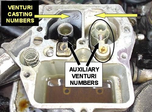

Hi Guys
I noticed that my B210 Carburetor is having different venture size as 9 and 11, are there any b210 came with this venture size ? , it means it is smaller than normal datsun 20 26 ventures , but i have not noticed any lack of pulling power on it but it gave me nice fuel figures ?
thanks

Hi Sumith, those numbers are on the Auxiliary Venturis.
The numbers for the main Venturis are cast at the top of the photo, and are generally 20/26 for A12 carburetors and up to 23/27 for A14 carburetors:

Sumith Posted on: 2013/3/18 6:45
Hi DD
ok then i misunderstood them , i will check it back
thanks

For clarification:

Hi DD
ok i can see 26 here
it should be 22/26 then
thanks
