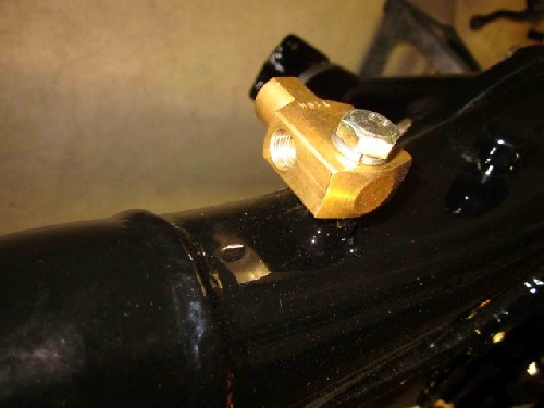

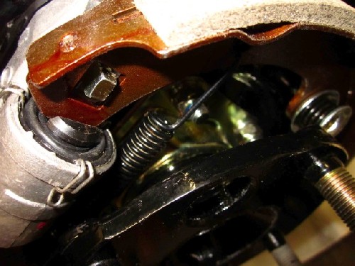

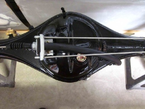

the diff has been completely stripped down, everything has been resprayed indiviually and all new parts have been used where possible. all new zinced high tensile bolts or re zinced original bits and pieces. all the parts have come from japan as you all know pretty much nothing is available in oz. all new cables, springs, packing gaskets, you name it its been changed. rear springs have been reset by 3", unfortunately no pics of that but they will come up later on in my post.
