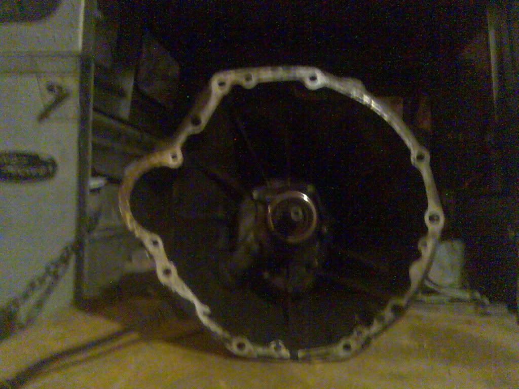

#21 Re: 63a #3 - 5 speed dogleg install query
Lowmion Posted on: 2010/5/3 10:37
regarding the conversion that A14force did, how much did it cost you? and I'm guessing you did most the work yourself?
#20 Re: 63a #3 - 5 speed dogleg install query
A14force Posted on: 2010/4/14 10:44
I've done it. BUT, you need to turn down the input shaft as the L sereis input ID, is bigger than the Spigot bush OD of the A series. Plus it needs a bit cut off the end too, as the L series input id longer than the A series one.
#19 Re: 63a #3 - 5 speed dogleg install query
ddgonzal Posted on: 2010/4/14 3:22
Yes, that 63A only fits L-series engine.
You need 63A for A-series engine. The Datsun 1200 auto driveshaft fits it.
If you find a broken 63A for A-series you *might* be able to swap the front casing. No one has actually tried this.
#18 Re: 63a #3 - 5 speed dogleg install query
WhiteSedan Posted on: 2010/4/13 11:00
Yeah thats the same as I have in my 1200, with a L16...
#17 Re: 63a #3 - 5 speed dogleg install query
Lowmion Posted on: 2010/4/13 11:00
yup it is I didnt think of checking that simple thing - just checked the view versus the manual :)
#16 Re: 63a #3 - 5 speed dogleg install query
ROConnor Posted on: 2010/4/13 10:54
Yeah sorry dude thats an L
#15 Re: 63a #3 - 5 speed dogleg install query
Lowmion Posted on: 2010/4/13 10:52
#14 Re: 63a #3 - 5 speed dogleg install query
Lowmion Posted on: 2010/4/13 10:51
#13 Re: 63a #3 - 5 speed dogleg install query
ROConnor Posted on: 2010/4/13 10:29
there was no 1600 a series or a series stanza so it hasto be L
