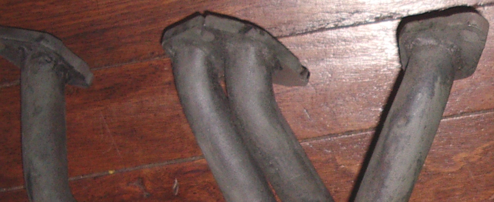

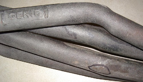

#15 Re: WTB extractors or twin outlet manifold to suit 1000
D Posted on: 2011/7/13 8:06
Ive got no name ones here but they dont fit at all in the
engine bay with an A10. As for the genie headers Neil is
right on the cherry and the crippling is in the nipple,
so removing the nipple helps or heating with massaging
will help keep the nipple in its place all warm.
1. shows overall 4-1 design (marked hitting point below)
2. 2nd/3rd ex. outlet, going down instead of straight out.
3. Close up where they hit (5-10mm should clear nipple)
jpg  IMGP0039.JPG (190.88 KB)
737_4e1d44a2bcd6f.jpg 933X534 px
jpg  IMGP0041.JPG (194.76 KB)
737_4e1d44ac2b993.jpg 992X406 px
jpg  IMGP0043.JPG (187.77 KB)
737_4e1d44b51a4f5.jpg 736X426 px
