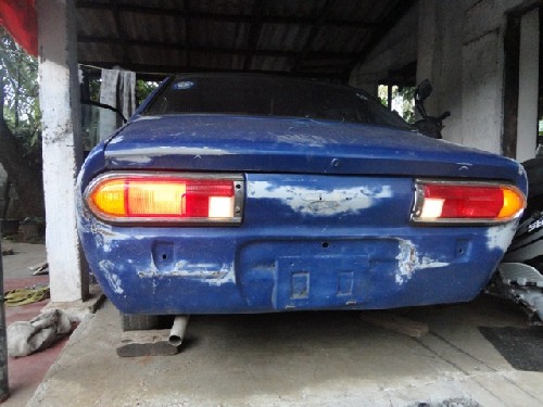

Hi Guys
i have finished all my required wiring on my b210, after few weeks painfull work,as the final stage , i wired Blower,Car Audio Set Up,3rd Stop Light and finaly was able
sorted out hazard (which share signal flasher) wiring which was the most confusing as i did not have working condition switch,Yet i don't know how to wire it to a switch
i have 3 wires which are connected to each other it works(must study a little more about),Next week i will be finishing wiring insulaion and dash board installation with my
new Led Plan etc etc ,
Does Any Body know how to wire Licence plate it has only 1 wire , it should be hot, how does it ground through ?
thanks
regards
sumith
