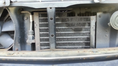

1200rc if you could take some pictures of your setup I would be very grateful.

I can take pics of my dealer fitted one. Condenser us in front of rad and new holes were made in the firewall

Appears to bolt in front of the radiator using the existing bolt holes.

Datsun 1000 mounted it in front of the radiator. 1200 improved it by mounting to the side with it's own fan. At least that was Datsun's intention. It was up to the installers to put in whatever they wanted.
In 1978 the first factory installation used a 2nd condenser

Has anyone got any pictures of where to mount the condensers?
I have the kit with two of them so not too sure which one goes where? One has a fan attached and the other is just on its own, perhaps one in front of the radiator and the other off to the side?
Also I am trying to figure out all the plumbing, have people made new holes in the firewall in the past or have they managed to use existing ports in the firewall.
