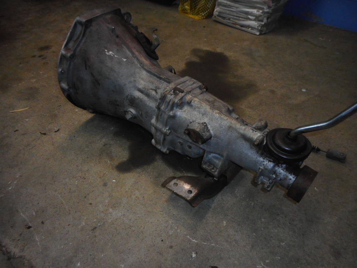

home-made gearbox crossmember designed to install 60L gearbox in any 1200 using the stock 60-series rubber mount
can also use it for 60A gearbox if you put 20mm spacer between body and crossmember
Notice that the mount on the 60L photo is higher than those on the 60A
