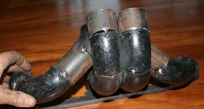

and i had a play with my turbo manifold for half an hour and got it mocked up but ran out of bends heres some pics
