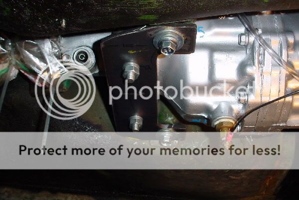

Mad-1200 Posted on: 2008/12/28 12:39
we talkin something like this
this for a 5 speed conversion
#6 Re: Auto to manual conversion
dazza1200 Posted on: 2008/12/29 6:27
ah!
so thats why my previously auto coupe has a home brew crossmember
plenty room for ca box but :)
#7 Re: Auto to manual conversion
DatsAndy Posted on: 2008/12/29 6:56
Yeah but i think going off mine and a 4 speed it will be a lot bigger as in U shaped not u shaped especially if you dont have the box with 2 mounting points one near the tail shaft input and one near speedo input get me drift ?. Also learn from my mistake and make it thicker say 5mm plate minimum i used 3 mm and it bowed within a week though it made a good template for a thicker one.

#9 Re: Auto to manual conversion
DatsAndy Posted on: 2008/12/29 9:02
Well i have herd the second holes are for an exhaust bracket, but they look usable for cross member to me. The 5 speed i sold conehead had the 2 mount points and some 56 a 4 speeds i have seen since have the 2 mount points. As far as specific models they came in I'm not sure others would know a whole lot more than i on this and many other matters or Wiki will give answers ive been using the wiki lately its awesome.
#10 Re: Auto to manual conversion
Mad-1200 Posted on: 2008/12/29 10:10
hey thanks for your help guys...
i could see how it would bend over time, its a fair distance, did your coupe have a plate made up like this andy?
i had a look through my gearbox collection and ive got 1 with the mounting holes by the tail shaft, pretty sure it has no reverse tho damit
