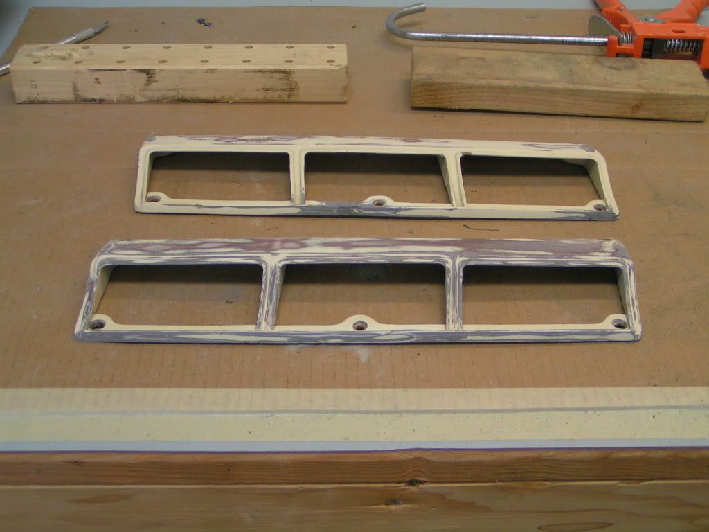

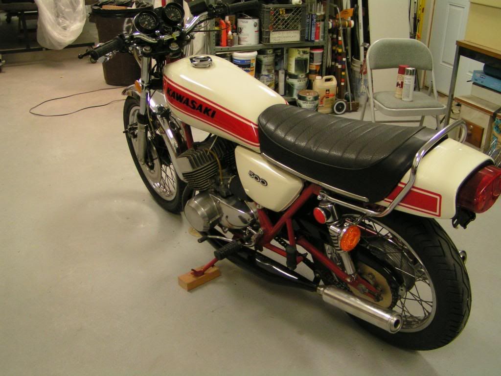

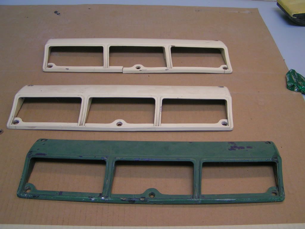

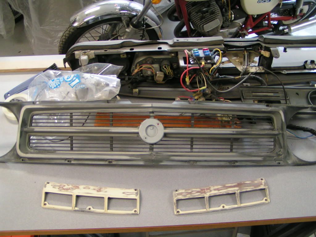

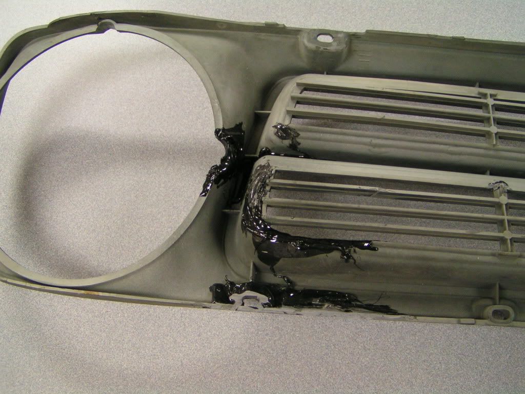

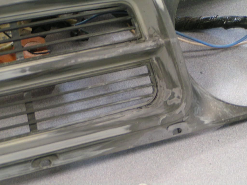

some pic's of the grill I resurrected & the cowl vents that had cracks as well...

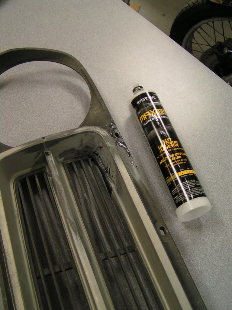

as you can see I built up the missing chunks out of the repair adhesive - this grill was broken in about 15 places w/big chunks missing along the bottom as well as the inside corner, the recessed groove line was completely gone
heres what I used
cowls before
After..

good on ya, i will have to try this.

I used fiberglass cloth and resin that works well too.

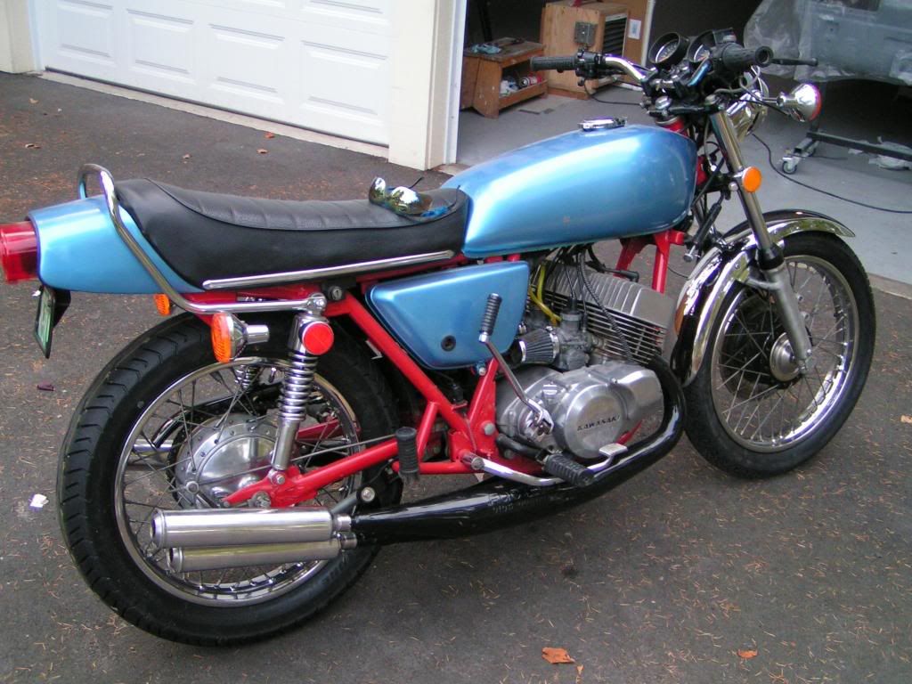

right bike, wrong year - 74 triple, finished the resurrection last year after 20+ years of dragging it around.
here's what I started with..hated my 20 year old paint choices
