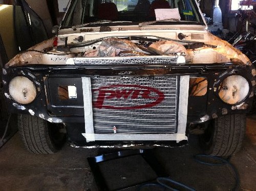

#9 Re: My Turbo 1200 Ute With Ca
TRU_DAT Posted on: 2012/1/14 11:32
So heres the body work that was done my mechanic/fabricator you can see some rust that was hideing away behind the fender panles which has now been sorted and he also Mocked up the brand new PWR radiater and intercooler to get abit of an idea. he also fitted the new radiater support panle and the apron gaurd. Yu can see the earlier pics i posted the apron is beyond repairs and it non exsistant.
