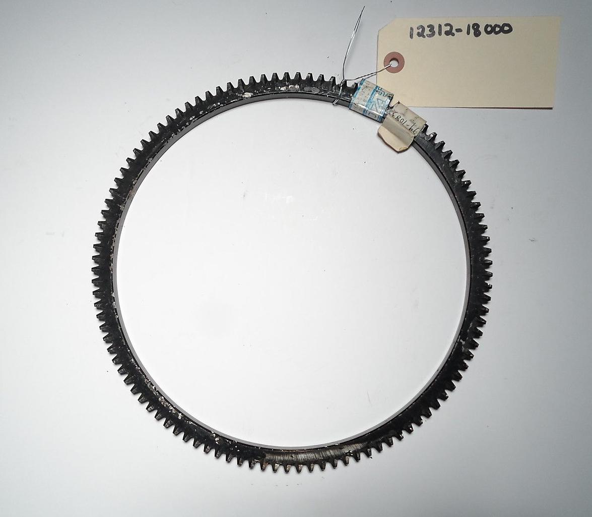

wanted-ring between clutch and flywheel apparently [per mechanic] has teeth and connects starterwanted for 73 1200

Flywheel Ring Gear - should be replaced if the starter makes bad grinding noise
Nissan part number 12312-18000 - $83
http://www.nissanpartsdeal.com/parts/ ... ing-gear~12312-18000.html
eBay $55
http://www.ebay.com/itm/Datsun-B110-1 ... 12312-18000-/311341635889
jpg  ring gear.jpg (83.70 KB)

I tried and couldn't get one in Australia so you might have to try DD's US suggestion or just go to the wreckers and get a good second handy.
I had a thought while looking for one , if you were desperate, could you pull the ring off and reset it 180deg around to bed on unused teeth as they seem to always wear in the same place (on compression)?
